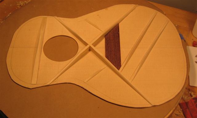

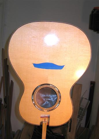

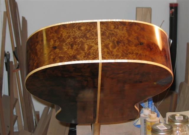

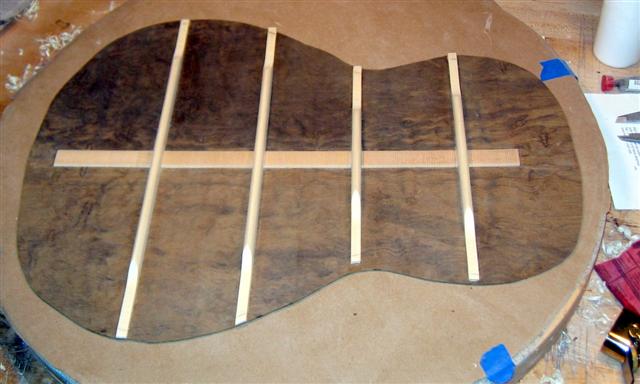

They seem to be as common as OM's these days, but here's one I'm working on. Needs two more finish coats of lacquer, but it's getting close...
Sitka Top
Imbuia B&S from Bob C via R Labbe in last year's swap meet
Gotoh tuners from Peter's group buy
Remaining bits and pieces from the usual suspects.
First time working with Imbuia, and it bent and machined much better than I expected given its figure. (The maple bindings were more of a hassle.) Second time working with a double m&t neck and I'm extremely happy with the results. The fretboard stays nice and straight and I love being able to string up the guitar and make any neck adjustments and do the fretjob before there's a drop of finish on the body. Plus as soon as it's buffed out you just re-glue the bridge and bolt on the neck and you're done. Almost instant gratification.
Thanks for looking.
Bob K
Sorry for all the pics, I guess I've been saving them up.

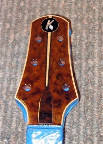

Bob, thats one fine looking guitar. I really like the stripe in your headstock.

I like it! Nice peghead, too.

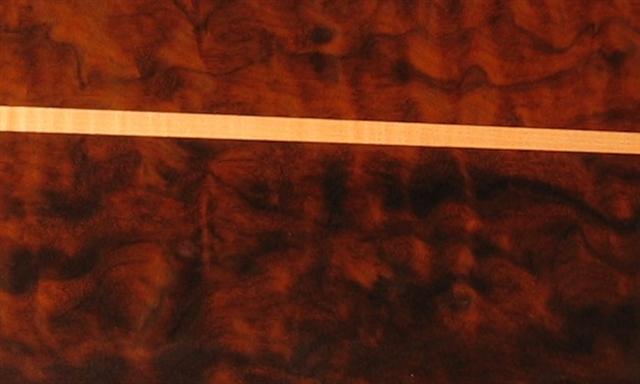

Wow, that figure really popped under the finish!
Beautiful work, as well as workmanship.

Wow! I really like that Imbuia!
The grain and color are outstanding!

Bob, absolutely stunning wood and workmanship. I too love the headstock.
